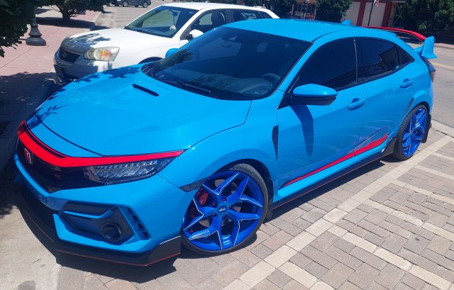

Did same on One Side Only - so far
my forearm had temporary metal pressure markings as i went from the top , opened the bonnet - hood and installed driver side Marker in SMOKE w led light bulb
ugh, the Passenger side i may need to remove 3 screws of wheel LINER and use flat head screw driver to pop-out Plastic Marker Housing AND push flat head into slot to pop-off wiring harness
took some TIGHT SPACE hand snap-together for me to finish just ONE SIDE in 11 minutes - yes, i currently have ORANGE stock on Passenger side - still (entering CAR Show in 6 weeks)
